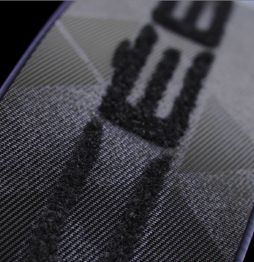

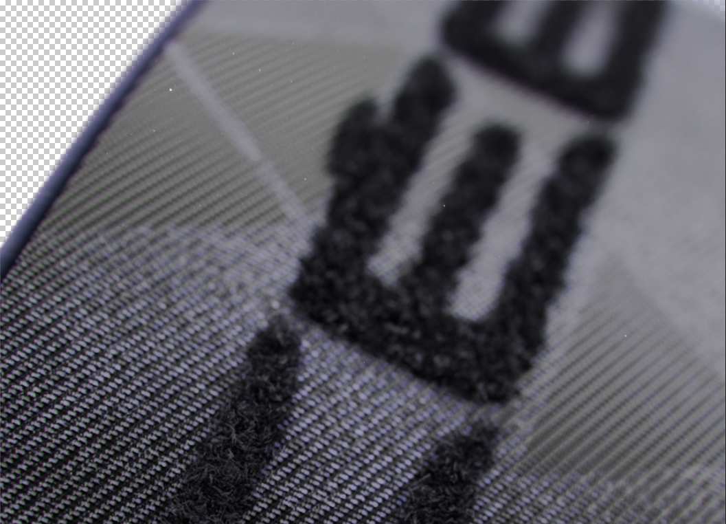

I’m facing something weird in my renders.
I’m rendering an animation and I have small dots in my image like small sparkels. I increased sample to 10’000 in GPU and they are still there.
But they are not present in the livetime rendering window.
Final file is EXT with a small amount of denoise ( denoise : .5 / firefly : .5)
First image : screenshot from keyshot rendering window at 40%
Second image : screenshot of the final EXR from photoshop

Did you try less firefly amount? If you don’t have shiny thing in your scene don’t use firefly. Sometimes if you use too much, it can do some weird effects. It helps starting with very small amount and increasing it as much as you need.
